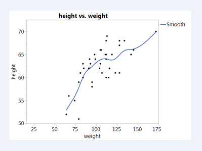

Another way:
dt=open("$sample_data/big class.jmp");
gb=dt<<Graph Builder(
  Size( 516, 446 ),
  Show Control Panel( 0 ),
  Variables( X( :weight ), Y( :height ) ),
  Elements( Points( X, Y, Legend( 3 ) ), Smoother( X, Y, Legend( 4 ) ) )
gb<<showtreestructure; // use this to discover the box you need
report(gb)[picturebox(1)]<<savepicture("$temp/gb.png","png");
open("$temp/gb.png");
