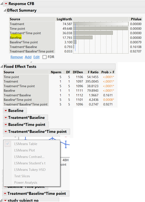

We notice the response size (i.e. change from baseline CFB) was smaller in data from test site A than test site B. And test site A baseline level mean is higher than that of test site B. So I want to understand from the data if sample with lower baseline would response more/ have a bigger CFB?
I repeat the Fit model, and put CFB in Y. The effect summary showed "baseline level" effect is sig as well as baseline level*treatment interaction.  But when looking into the effect details, there's nothing to show under baseline level effects. All the items plot, student T are greyed. I couldn't learn if higher baseline leads to smaller or bigger CFB.
How to best explore this question and have some more detailed results/plots than just a p?

Would it be possible to see a snapshot of your model output (you can hide any confidential / sensitive information prior to sharing).
At first glance, the leverage plot should give you the directionality and magnitude of the effect. I also find the Profiler to be a useful tool to understand the relationships between outcome and variables.

Hi Thierry, Thank you for reach out.
There are the snapshot of the report parts that relevant to baseline level. All items are not available in the profilers of baseline level related effect. I don't have a clue of why.
