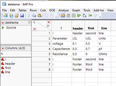

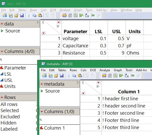

One way:
filename = Save Text File(
	"$temp/deleteme.txt",
	"\[! header first line
! header second line
Parameter         LSL   USL     Units
voltage              0.1    0.5        V
Capacitance     0.3    0.7       pF
Resistance        0.5     9       Ohms
! Footer second line
! Footer third line
! Footer third line]\"
lines = Words( Load Text File( filename ), "\!n\!r" );
metadata = {};
data = {};
For( i = 1, i <= N Items( lines ), i += 1,
	line = lines[i];
	If( Starts With( line, "!" ),
		Insert Into( metadata, line ),
		Insert Into( data, line )
datafilename = Save Text File( "$temp\data.txt", Concat Items( data, "\!n" ) );
metafilename = Save Text File( "$temp\metadata.txt", Concat Items( metadata, "\!n" ) );
dtData = Open( datafilename, Import Settings( End Of Field( Tab, Spaces, Space ) ) );
dtMetadata = Open( metafilename, Import Settings( Labels( 0 ) ) );
meta data separated from datameta data separated from data

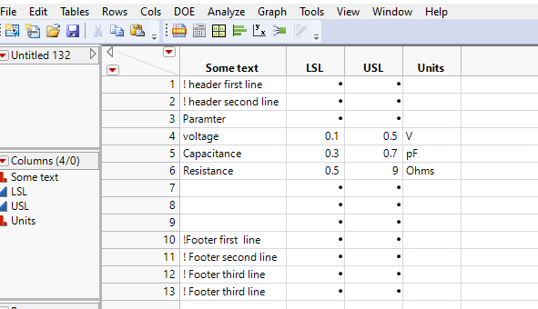

@txnelson. Below is how it looks like. I would like to do the following
1. Separate the header and footer text into one list.
2. Separate the data between the header and foot except the empty line into a data table.
3. Count the number of empty entries in the data table (they change depending on which text file is loaded)
Thanks.

Re: How to exclude header and footer when using open () to import a text file, in JSL?
Here is a simple example of what I think you need.
Names Default To Here( 1 );
dt = Current Data Table();
headFootList = {};
col1Name = Column( 1 ) << get name;
Eval(
	Parse(
		Eval Insert(
			"For Each Row( If( Contains( :^col1Name^, \!"!\!" ) == 1, Insert Into( headFootList, :^col1Name^ ) ) )"
Eval(
	Parse(
		Eval Insert(
			"emptyCount = N Rows( dt << get rows where( :^col1Name^ == \!"\!" ) )"
Eval(
	Parse(
		Eval Insert(
			"dt << select where( contains(:^col1Name^,\!"!\!")==1 | :^col1Name^ == \!"\!")"
Try( dt << delete rows );
dtHeadFoot = New Table( "Headers and Footers",
	New Column( "Headers and Footers", character, set values( headFootList ) )
New Window( "Count of Empty Rows",
	<<modal,
	Spacer Box( size( 0, 15 ) ),
	H List Box( Text Box( "The numer of empty rows is: " || Char( emptyCount ) ) )
Jim
