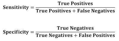

Hi,
Considering that nobody has contributed yet, let me take a stab at your question. To the best of my knowledge, the Specificity and Sensitivity of a test do not depend on sample size. But, the precision of the estimates for Specificity and Sensitivity is dependent on sample size. Therefore, if I understand your inquiry correctly, you will not modify the Specificity or Sensitivity by adding more samples to your experiment.
However, if your question is about the mixture of positive and negative cases in your experiment, then you can easily derive those from the definition of Sensitivity and Specificity.
