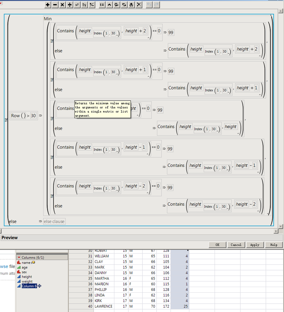

lwx228
Level VIII
Re: How to efficiently find the first position in a specified range of data that meets the requirements?
I tried this stupid method and got results.Ask the experts Can this formula be simplified?
Thanks!
If( Row() > 30,
r1 = Contains( height[Index( 1, 30 )], height + 2 );
r2 = Contains( height[Index( 1, 30 )], height + 1 );
r3 = Contains( height[Index( 1, 30 )], height );
r4 = Contains( height[Index( 1, 30 )], height - 1 );
r5 = Contains( height[Index( 1, 30 )], height - 2 );
Min( If( r1 == 0, 99, r1 ), If( r2 == 0, 99, r2 ), If( r3 == 0, 99, r3 ), If( r4 == 0, 99, r4 ), If( r5 == 0, 99, r5 ) );
