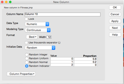

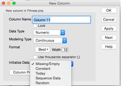

Have you tried making a new column in your data set and initializing the new column and choosing Random followed by Random Indicator where you can specify the proportion that you desire for your split.

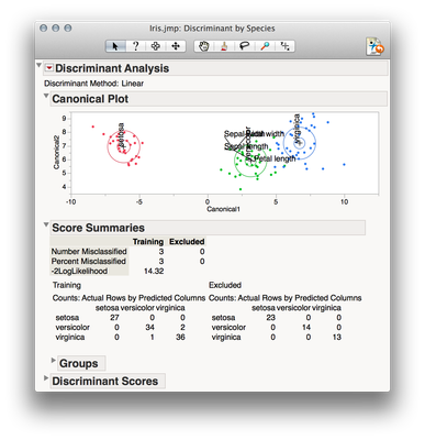

It sounds like you have found the answer, but in case not I wanted to point out that discriminant analysis in JMP uses excluded rows as the validation set. So, once you've made your column to identify rows for training and validation, select all the validation rows and exclude them (you can select them all with Rows > Data Filter, or right click one validation cell, and use "Select Matching," then Rows > Exclude). Now, when you run DA JMP will automatically fit for both the training and validation sets, and give you classification statistics for your validation (excluded rows) set (see screenshot below).
Here's a link to the help page for validation in DA: Validation in Discriminant Analysis
I hope this helps!
Julian
