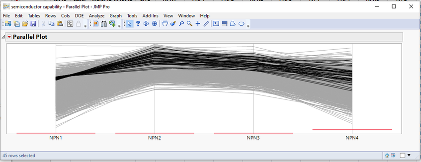

Hello,
 I am using a parallel graph to highlight some outliers. I'd like to make the curves for these outliers more prominent by putting the other curves as a muted background. How can I mute or make more transparent (?) most of the graph curves? I thought I could use the "customize" feature to reduce the transparency of curves I've selected but it applies it to all curves, so there's no way to separate the outliers. Any help would be greatly appreciated!

Just select the curves you want to highlight, and the others will become muted.
Jim

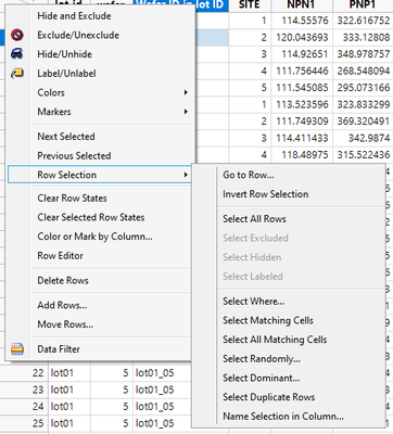

An easy way to display the rows one wants to display, is to the row selection built into JMP.

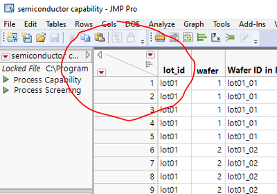

Right click on the header of the RowState
and it will bring up the selections below
If these built in features do not meet your needs then a JMP script will probably have to be written to select the desired rows.
