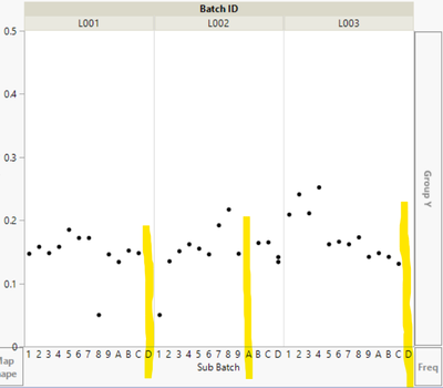

Hello,
How can I edit a unique x-axis in the graph bulider when grouping data. As you can see in the example, each group has the same x-axis even though there is no data in the group (highlighted in yellow). How can I edit a unique x-axis for each group so that no empty "spots" appear in the chart?
Thanks for your help

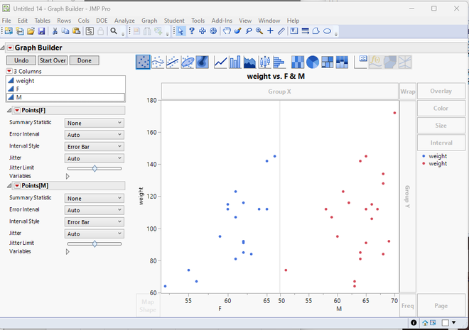

What you will need to do is to Split your data into multiple columns based upon your grouping.  Then you can drag the separate columns onto the X axis, and you will be able to independently modify the 3 axes.  Here is an example using the Big Class sample data table, Splitting the height data into separate columns based upon Sex.

If you want to use one column as Group X and another column on the X Axis, it is NOT possible to remove the white spots:
X group -> adjust axis
But there is this post in the wish list: X group: restrict the values on the axis to the respective group
I hope enough users support it such that it gets fixed in a future version of Jmp.
Workaround:
Instead of using a column as Group X, drag it just below the X axis to add a second level of hierarchy:

If the value on the x axis are continuous, Jmp won't allow you to add a nominal column as a second level. Then you have to split the values like @txnelson  already suggested in his reply
(a step-by-step guide (c) @txnelson can be found here: https://community.jmp.com/t5/Discussions/X-group-gt-adjust-axis/m-p/542288/highlight/true#M76187)
