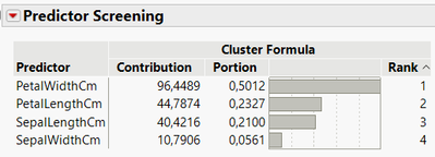

  1. When using the Predictor screening platform, entering the cluster formula as the Y, response and the factors as X's, I can have a look at the difference in contributions of my factors on the clustering :
  2. When using the "Fit Y by X" platform, entering the cluster formula as X and the factors as Y's, I do a Welch's test and create a combined datatable with all F ratio. With a graph showing the F ratio depending on the factors, I'm able to find similar results :
    There is a difference between the two platforms and an exchange between the two biggest clustering contributors factors, because petal length and petal width have both two non-normal distributions. Hence the Welch's test wouldn't be the most appropriate option here, but a Steel-Dwass All Pair test would be probably better.
    On this dataset, the Predictor screening would be a safer option as it is robust against outliers, and does not require assumtions about the data distributions (the platform uses a Random Forest model).
