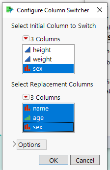

You can use column switcher for this
-Jarmo

Hi Jarmo, this is true, but obviously I have to be more precise: The column switcher would need to affect only the color column, not let's say the x or y column.

Isn't that exactly what column switcher does? Only "issue" with column switcher is that you cannot have same column in multiple roles at the same time.
-Jarmo
