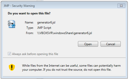

When I open files with scripts, I got "JMP security warning" with three options: Examine, Open and cancel (see attached).
The option for "always ask before opening this file" is disable.
How can I disable it and make the JMP to always open it w/o this popup?

The file server share needs to be added to your trusted zone.
Server is not in the trusted zone, yetServer is not in the trusted zone, yet

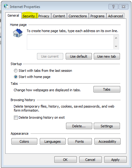

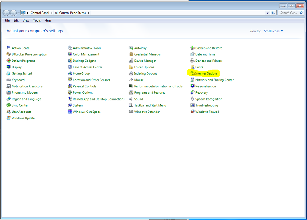

to implicitly trust content from this share, use the control panel Internet Options applet. (Note that anyone that has access to the server can change the file. That's why it isn't implicitly trusted by default.)

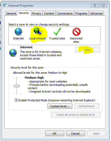

Control Panel internet optionsControl Panel internet options go to the security tab.
Choose the security tabChoose the security tab
open the local intranet sites.
Pick local intranetPick local intranet

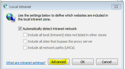

go to the advanced settings.
Advanced settingsAdvanced settings

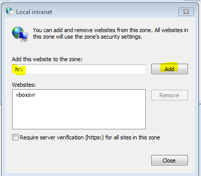

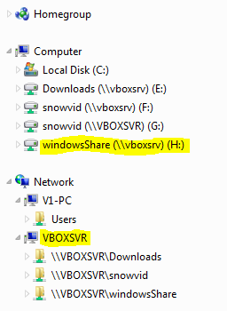

I needed two different names for the same place. VBoxSvr is the name of the server, and H:\ is a drive letter mapping.
Look at the server shares in the explorerLook at the server shares in the explorer
Add a drive letterAdd a drive letter

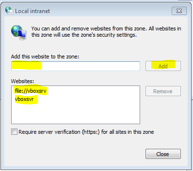

add them both, then close/OK all the way back.
Add the serverAdd the server
No more security prompt!
The three check boxes on the sites dialog also make it work, but I think it is better to be a little more specific with the advanced dialog about which servers are OK.

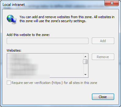

Do you know if it is possible to disable the security warning from the JMP-end, perhaps from the preferences?
The reason being that the Internet Options settings in many organisations are configured by the administrator. Thereby making the solution slightly more complicated.

Thanks for the explanation. However, what if you're in a IT restricted situation? Where you have no control or access to the Internet Options?
