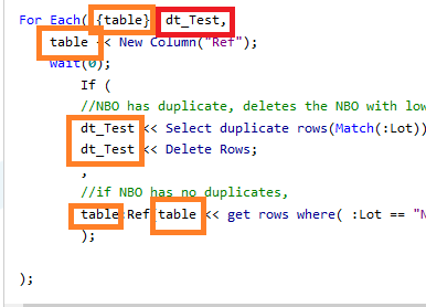

I have this piece of code but I'm quite not sure if there is a more appropriate approach to this. My loop gets an error because some of the data table have multiple NBO values.
Data out of range at row 10 in access or evaluation of 'For Each' , For Each/*###*/({table}, dt_Test, table << New Column( "Ref" ) ; Wait( 0 ) ; table
:Ref[table << get rows where( :Lot == "NBO" & :N Rows == Col Max( :N Rows, :Lot ) )]
= 1)
So what I am trying to do is create an If statement inside the For Each loop. The IF statement will determine if NBO is has no duplicates on the Lot Column, if it has no duplicates, then it will put 1 on Ref column.
For Each( {table}, dt_Test,
	table << New Column("Ref");
	wait(0);
		If (
		//NBO has duplicate, deletes the NBO with lowest N Row value
		dt_Test << Select duplicate rows(Match(:Lot)); //only selects the matching values, how can I delete the NBO with lowest N Rows count?
		dt_Test << Delete Rows;
		//if NBO has no duplicates,
		table:Ref[table << get rows where( :Lot == "NBO" & :N Rows == col max(:N Rows, :Lot))]=1;

Maybe the issue is somewhere else? What does dt_test contain for example? And dt_test and table are used in a bit weird manner (also the if might not be doing what you think here)
I would modify your code a bit to make it easier to debug (don't place get rows where inside the [])
Names Default To Here(1);
dt = Open("$DOWNLOADS/dt.jmp");
dt2 = Open("$DOWNLOADS/dt2.jmp");
dts = Eval List({dt, dt2});
For Each({cur_dt}, dts,
	cur_dt << New Column("Ref");
	//cur_dt = dts[2];
	sel_rows = cur_dt << get rows where(:Lot == "NBO" & :N Rows == Col Max(:N Rows, :Lot));
	cur_dt:Ref[sel_rows] = 1;
This way you can print the sel_rows and see if it is empty / what it has
-Jarmo
