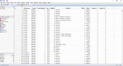

How to delete rows based upon a condition
how to make a formula to delete certain rows in column. tasked with deleting all unknowns in the column as well as mixtures of the cultivars. The issue is that the rows are words and a formula in jmp must be used to get full credit for this exercise. attached is a screenshot of the jmp file with the cultivars column. must delete the unknowns and the mixture of cultivars.

@uday_guntupalli I am going to upload the file. The file is in excel and we had to copy and paste it as values in excel and then upload from to into jmp. The columns that we are supposed to work with are the Cultivar and mono column. We have been tasked with using a formula to delete specific items in the cultivar column. I have tried this numerous ways and it just deletes the entire column. We have to make a formula to delete the data in which the word unknown appears and also if there are multiple cultivars listed (more than one cultivar per row); ending up with the cultivars that are just one word. I am attaching the excel data in hopes that someone will be able to help me. I have been struggling and have tried to use a formula at least 20 times all with the same outcome of deleting the column.
They said that the mono column is supposed to help us but I am not sure how because not everything matches meaning that not every uknown has 3 and not every single word has a 1, and not 2 or 3 words have a 2 or a 3.

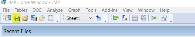

      Are you supposed to use the tab "Data_for_JMP" or "Sheet1". I am assuming the "Data_for_JMP" is the right one. I am going to provide step by step instructions on what to do - but I want you to keep in mind and understand, as a community member I wouldn't be offering a solution knowing it is a homework problem. I will only provide advice so you make a fair attempt at solving it on your own. If you share your work, the community will always be glad to help you, but I will not solve the problem for you as the intent is for you to make an attempt on your own using tools at your disposal.
     Now, let us go over the attachment, assuming "Data_for_JMP" is the sheet with the data you want ,
Step 1: Import the data into JMP
When you open JMP, navigate to File ==> Open . Select the excel file. This should give you the following interface:
Step 2: Now you have your raw data in JMP from Excel as a data table, open a new script
Step 3: Use the example shown below to delete rows that meet your condition
Clear Log(); Clear Globals();
dt = Current Data Table();
// Assuming you need to delete the "Twymax" in the Cultivars Column
// Select Rows where this condition is satisfied
dt << Select Where(:Cultivars == "Twymax");
// Delete Rows
dt << Delete Rows;
The above acheives what you need. You will need to edit the script I am providing for your conditions. If you have any further trouble, please share your script or your attempts.
