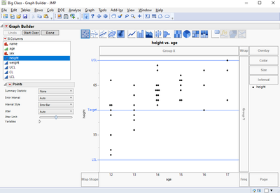

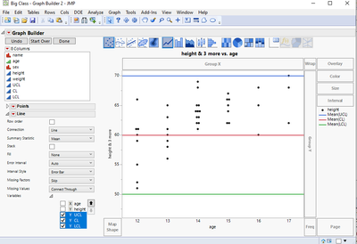

Or plot those columns directly:

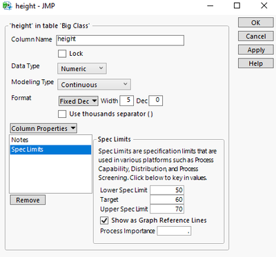

or set those to column properties as spec limits:
All these can be scripted if needed.
