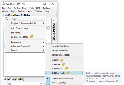

Workflows do have For Each (in JMP18) which you might be able to utilize

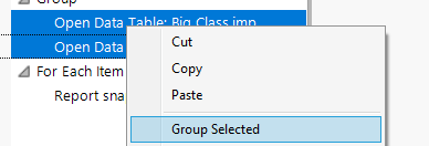

Open tables and group them

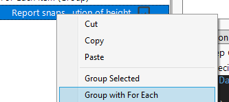

Run analysis on one table and group it to for each
Use group defined first as source for for each group

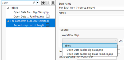

I tried your recommendation and created the workflow above. The workflow opened all three files. Then, it stopped and asked me to select a file to run the control chart. Any other recommendations?

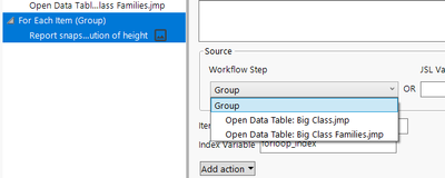

You didn't select source for the for each (you have to tell it to use the Group you created earlier)
You can also rename the group (and you should) by changing the step name of the group

Re: How to create a workflow that can run a set of analyses for multiple files in one folder
Yeah, it worked!
Jarmo, thank you so much! :)
