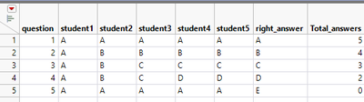

Let's start with this table (total_answers is there just to show correct amount):

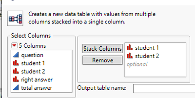

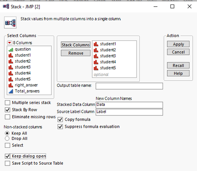

1. Stack

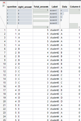

2. Add formula (Column 6):

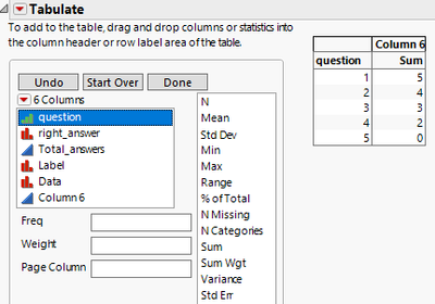

3. Tabulate (or summary):
Also take care that the column Data Types and Modeling Types are correct for the data you are modeling.
Example table with a bit more advanced formula which I wouldn't suggest using until you learn a bit more about JSL:
Names Default To Here(1);
dt = New Table("Untitled 4",
	Add Rows(5),
	Set Header Height(50),
	New Column("question", Numeric, "Ordinal", Format("Best", 12), Set Values([1, 2, 3, 4, 5])),
	New Column("student1", Character, "Nominal", Set Values({"A", "A", "A", "A", "A"})),
	New Column("student2", Character, "Nominal", Set Values({"A", "B", "B", "B", "A"})),
	New Column("student3", Character, "Nominal", Set Values({"A", "B", "C", "C", "A"})),
	New Column("student4", Character, "Nominal", Set Values({"A", "B", "C", "D", "A"})),
	New Column("student5", Character, "Nominal", Set Values({"A", "B", "C", "D", "A"})),
	New Column("right_answer", Character, "Nominal", Set Values({"A", "B", "C", "D", "E"}))
//Don' use if you don't have clear understanding what this does! Try first using data table method
//2::5 indicates indices of student result columns
dt << New Column("Total_answers", Numeric, Continuous,
	<< Formula(
		N Items(Loc(Current Data Table()[Row(), 2::6], :right_answer))
-Jarmo

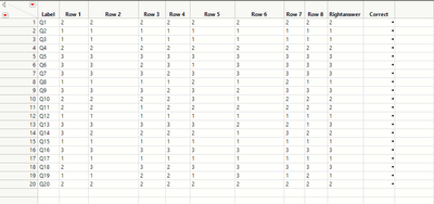

lehoth
Level II
Re: How to create a column that counts the total specified values form other columns?
what if I have many students, I tried to do a for loop based on your suggestion, but I couldn't get it.
(I also collect in other classes)

1. Stack

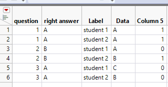

Datatables: Stack table with student columns:
Add formula to check differences between answer and and right answer:
Formula for Column 5:
If(:right answer == :Data,
	1,
	0
Create tabulate/summary (you might have to change the modeling type of question to Nominal or Ordinal):
