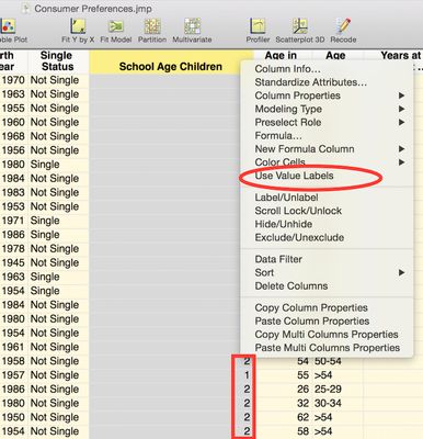

Hello,
If I am understanding your question correctly.
You can turn the value labels on or off through the column properties.
In this example using the Consumer Preferences from the sample data I was able to right-click on the column and uncheck the value label option.
The column is no longer using the value label as shown below.
I hope this helps.
Best,
Stan

Hi Stanley, Thanks for trying to help.  I know the function of value labels, but what I need is to change or substitute 1,2,3 values to No, Yes (e.g. as in your example) character values.
I need to join two tables with matching columns one of which has character values (same as the value labels in the other table, i.e., no coding was used), the other has numeric values (codes) with value labels.
Or is there a way to join the tables on the fly based on a column's value labels in one table and actual values in the matching column in the other table?
Best regards
Jens
