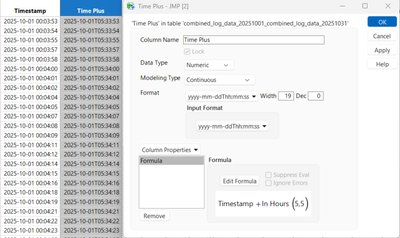

Is this an option?
New Column( "Time Plus",
Numeric,
"Continuous",
Format( "yyyy-mm-ddThh:mm:ss", 19, 0 ),
Input Format( "yyyy-mm-ddThh:mm:ss", 0 ),
Formula( :Timestamp + In Hours( 5.5 ) ),
Set Selected
