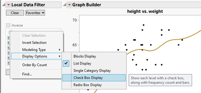

Easiest option would most likely be to use Data Filter
