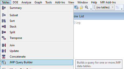

Have you tried with JMP Query Builder?

I agree with @jthi 's recommendation to use Query Builder...you can make the connection and execute the query all within the Query Builder platform. Here's a link to the JMP documentation with details: Connect to SQL database
