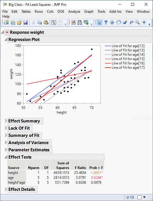

A linear model expects pairs of (X,Y), but you describe a case where X=1 for more than one Y in each group. How can that situation be?
Here is an example of what I mean using the Big Class data table in the Sample Data folder. Run the script to see what I am talking about and see if it might work in your case.

Here is the result:
The interaction term is the key. It is used to test the question, "Does the slope depend on the age group?" This case suggests that it does not, because this term is not significant with 95% confidence.
Your grouping is more complex (not just a single variable like :age), but the idea is the same. So think about which variables can be used to define a group, and then use a formula to create the grouping variable for the regression analysis.

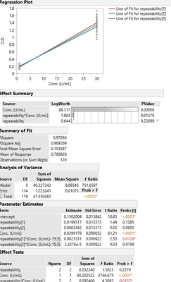

How the interpretation would be wrong,
I FINALLY got to the destination to get this figure!!
Your help was great for me!
I am little bit confuse whether should I allocate [By] factor with "day, run, etc..'.
But that is not important for now.
You solved the situation.

Dear,
One last thing to check...
In the picture I posted,
Can I conclude that there is significant different in slope (interaction term) and not significant in intercept term ?
Thus in this case I suppose I can conclude that,
Although slope is different, intercept considered to be same, thus, there is no difference among repeatability 1~3.
(as I know, ANCOVA difference needs both slope difference and intercept difference)
Can you agree ?
Re: How to compare multiple straight lines ? (y=ax+b)
I would interpret this analysis the same way as you did. There is no constant bias between the groups, but there is proportional bias.
