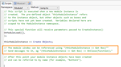

Re: How to close App using JSL?
One thing to keep in mind is that every window created by a JMP Application is associated with a Module Instance.  In the script for the module, you can do something like:
(thisModuleInstance << Get Box) << Close Window;
You could just as well use any of the boxes that define the content of the module.  You will see that this approach is used in the sample JMP Application "Launcher With Report".  In this example, a launch window is created in one module to collect input, and on "OK" the launch window is closed and the report window is created.
jsdejmp
Level II
This is what I needed. Since 'thisModuleInstance' is reserved, it would be helpful to add some documentation when a user creates a new application, eg
