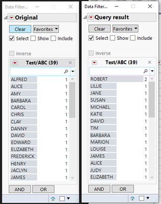

I think Batch/Reactor isn't valid column name if you are using it like that. Try changing it to :"Batch/Reacher"n. You also might want to add wait(0) after the sort just to be sure.
Below is an example using JMP example table and On Run Complete instead of Post Query Script
Names Default To Here(1);
Column(dt, 1) << Set NAme("Test/ABC");
dtquery = New SQL Query(
	Version(130),
	Connection("JMP"),
	JMP Tables(
		["Big Class" => "\C:\Program Files\JMP\JMPPRO\18\Samples\Data\Big Class.jmp"
	QueryName("SQLQuery1"),
	Select(
		Column("Test/ABC", "t1"),
		Column(
			"age",
			"t1",
			Analysis Type("Ordinal"),
			Numeric Format("Fixed Dec", "0", "NO", "")
		Column("sex", "t1"),
		Column("height", "t1", Numeric Format("Fixed Dec", "0", "NO", ""))
	From(Table("Big Class", Alias("t1"))),
) << Run Foreground(
	On Run Complete(
		queryResult << Sort(By(:height), Replace Table, Order(Ascending));
		wait(0);
		queryResult:"Test/ABC"n << Set Property(
			"Value Order",
			{Common Order(0), Numerical Order(0), Row Order Levels(1)}
-Jarmo
