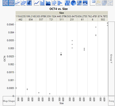

I am very new to JMP and I want to change the number of level for my group X. I want to separate them as two different region.
From here,

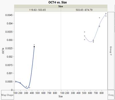

By having 2 for the number of level, I got this
How to divide 2 level 100-400 and 400>

What you need to do, is to create a new column in your data table, and using a formula, assign the rows to one of the two groups you they should be in.  Then, when you use Graph Builder, us the the new column as the X Grouping column

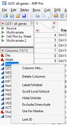

Hi Txnelson,
Thank you so much for your reply! I tried to make binning formula from the column menu and I found out I don't have 'utilities' option.
Do you have any ideas how to find 'utilities' option?
joepark
Level III
Re: How to change the number of level for Group X on Graph Builder?
Sorry I just found the option under the menu bar.
