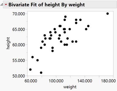

A better solution (again my opinion) is to select all your relevant columns in the table, then use Standardize Attributes... (from the Cols menu) to add an Axis Column Property, where you can define the exact format in which these variables will be presented on the axes. I did this for the height and weight columns in the attached example.
I don't know if that would set the decimal places for every report - it probably depends which reports you are using.
If you need to do this a lot then you can maybe write a script that would add this Column Property for all continuous columns in a data table. Workflow Builder should give you a good start on that. Or, if you need it to be more flexible, you could even write an addin.
