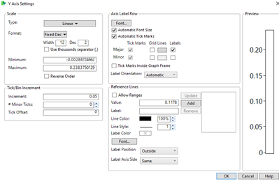

Re: How to change the graph frame thickness and color in Graph Builder?
Thank you for the feedback. Perhaps I am missing something, but when I am in the axis settings window  I do not see an option(s) for the following:
1. Changing the color of the axes lines/ticks
2. Changing the thickness of the axes lines and ticks.
If I go to preferences, I can see the options to change the color of the axes lines and if I want a border around the graph frame, but I do not see the option to change the thickness of those lines. I do see options where I can change the thickness of graphed lines, but again not the thickness of the axes lines.
Do these need to be changed via script?
