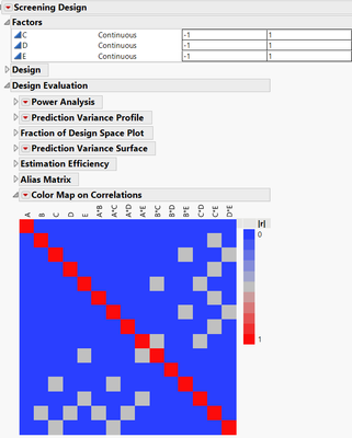

I am trying to construct a fractional factorial design by the screening design platform,and the design I want to make is a 2(5-1)design with the generator of I=ABCD.this is not a abbreviation design,so I want to change the generator from ABCDE to ABCD.but it looks impossible to generate this design by change the generating rules in screening design platform.
if I dont click any of them I get a design which all runs with a positive E level.if Iclick all I get a abbreviation design with generator I=ABCDE

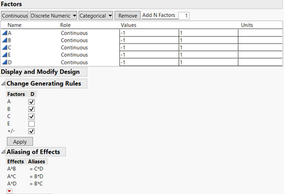

  • By default, JMP tries to find the highest resolution generator depending on the number of factors and reduction you have described. Note that you can still change the proposed generator and finds another one by checking the cases. For example, instead of resolution V generator described by I = ABCDE, I can also use the generator I = ABCE (equivalent to your generator I =ABCD, resolution IV: No main effects are aliased with two-factor interactions, but two-factor interactions are aliased with each other.) by dechecking the case DxE :
    If you order your factors like ABCED, you can propose the generator I = ABCD by dechecking the case ExD :
    However in this situation, I don't know what would be the benefit of using a resolution IV generator when you could use a resolution V generator ?

and thanks for your answer, now I know how to get this resolution IV design.
