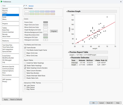

You can change your preferences regarding the default option of the platforms and graphs. To do this, go into "File", "Preferences", and then check the panel tab "Style". You should find options for the graph background colors :
Hope this answer will help you !

Excellent! Thank you so much.
