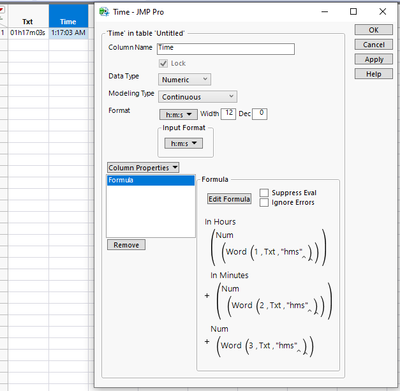

jthi
Re: How to change a column to time if its in a strange format
You could use a formula where :txt is your column with time:
InHours(Num(Word(1, :Txt, "hms"))) + InMinutes(Num(Word(2, :Txt, "hms"))) + Num(Word(3, :Txt, "hms"))
And then change the column to Numeric continuous and format as Time h:m:s (might differ depending on your time format)
-Jarmo

jthi
-Jarmo
