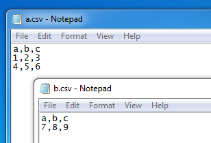

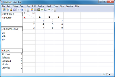

If you used File->Open->TextFile to import a CSV, for example, there should be a script in the imported file that you can use/modify to import another file.
You can use JMP's Table->Concatenate to combine tables.
aa = Open( "C:\Users\User\Desktop\a.csv" );
bb = Open( "C:\Users\User\Desktop\b.csv" );
cc = aa << Concatenate( bb );
Close( aa, "nosave" );
Close( bb, "nosave" );
