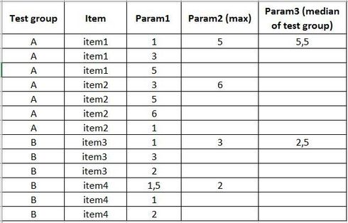

Hello everybody,
I have test groups A and B, 4 different items, Param2 (being the maximum of Param1 values) saved in the first cell of corresponding item. The values of Param2 are sometimes provided per hand. Now I would like to calculate the median of Param2 for each test group and save it again
in the first cell where each test group starts, like in the table below. I would appreciate for hints how I can do that in script.
Thank you and best regards.

Use Col Median to calculate median over groups. Then combine that with if-statement which checks for first row of the group using Col Min
Example:

Hi,
thank you for suggestion. It is working, however I noticed that I have in data some other even high-level groups for which median within lower-level groups need to be calculated. I slightly adapted the if statement:
Best regards
dt << New Column("Med", Numeric, Continuous, Formula(
	If(Row() == Col Min(Row(), :High_level_Group, :Low_level_Group),
		Col Median(:Param, :High_level_Group, :Low_level_Group)
