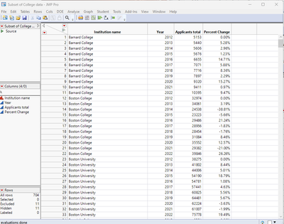

I'm working on a project examining the number of applicants to highly selective universities in the United States from 2011-2022.  I'd like to calculate the year-over-year percentage change of the total number of applicants by school.  I have tried to work with "group by" and also create a lag variable, but I can't quite figure it out.
Help -- any ideas on how to do this?  Thanks!

See if this is close to what you want:
Names Default To Here( 1 );
dt = Current Data Table();
dtPercent = dt << subset(
	columns( :Institution name, :Year, :Applicants total ),
	selected rows( 0 )
dtPercent << sort( by( :Institution Name, Year ), replace table( 1 ) );
dtPercent << New Column( "Percent Change",
	Format( "percent", 9, 2 ),
	set each value(
		If( Row() == 1 | Lag( :Institution name ) != :Institution name,
			:Percent Change = 0,
			:Percent Change = 1 - Lag( :Applicants total ) / :Applicants total

Re: How to calculate percentage change applicants by school year over year?
You can also use Col Moving Average() to calculate value from earlier row for a group and then calculate with that (data must be sorted by year)
1 - (Col Moving Average(:Applicants total, 1, 1, 0, 1, :Institution name) * 2 -
:Applicants total) / :Applicants total
Here data is also sorted by Institution but it isn't necessary
-Jarmo

Great solution -- thank you!
