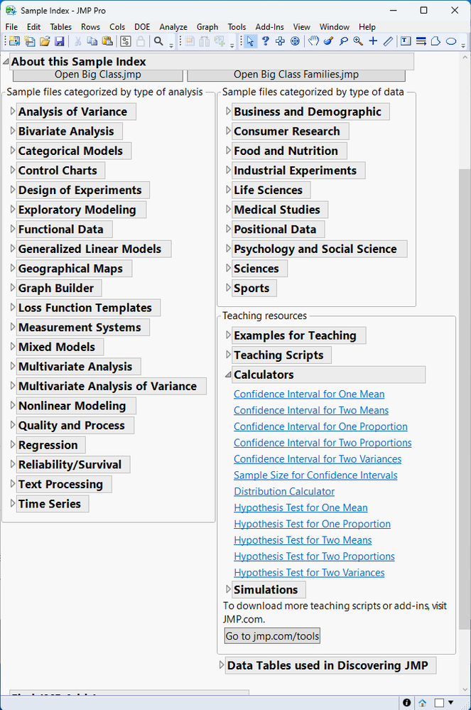

it's easy to carry out with on-line calculator, screenshot is an example.  my question is how to calculate Z score and P value with JMP?

It is not a Pro feature. I do not have JMP 16 installed. I think it was about the same in JMP 17, which I have installed. Try the Sample Data Library command in the Help menu. Does it look at all like this:
If so, notice the calculators in the lower right corner.

Re: How to calculate Z-score test for two population proportions
Select Help > Sample Index. Select Tool for Content Type. Select Calculators for Tool Type.

thank you for timely reply @Mark_Bailey  my JMP version is 16.0.0, but it isn't pro version. I don't find sample index in my help menu...
