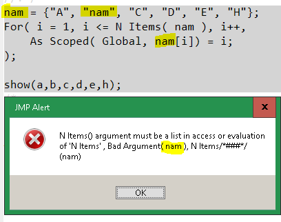

I agree, most times I'd prefer a real associative array over this technique because your code can break in a terrible way if the { list of variable names } happens to include a real variable in your code that you don't want overwritten:
The list holding "nam" just clobbered the variable 'nam' which held the list...The list holding "nam" just clobbered the variable 'nam' which held the list...
