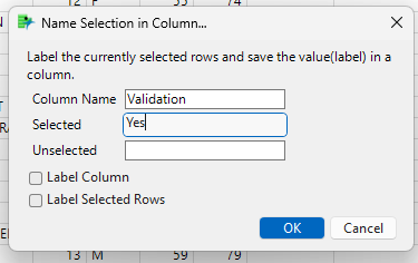

If not use formula, is there any simple way to batch fill 'Yes' in the <validation> column for the selected multiple rows?
jthi
Re: How to batch fill 'Yes' in the column for the selected multiple rows
  1. Add "Yes" to clipboard
  2. Select the column and rows
  3. Paste the values

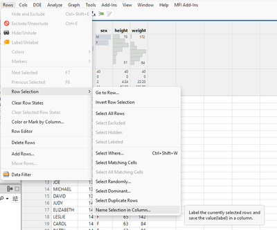

You can also use Name Selection In Column... (Rows > Row Selection > Name Selection in Column...)
-Jarmo
2 REPLIES 2
jthi
  3. Paste the values
-Jarmo
ChernoffTurtle7
Level III
I like both. Thanks!
