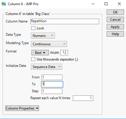

If making the Repetition a numeric value is an option, then you could simply create the new column, and then go to Col Info, and under "Initialize Data" select "Sequence Data" and then specify a sequence of 1 to 3

Thank you! It works perfectly. Have a nice day.
