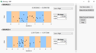

Hi JMP Community,
Is it possible to use the Column Utilities > Make Binning Formula to create bins based on tertiles or quartiles?

I don't think 'Make Binning Formula' will do that. But take a look at this add-in. I 'think' the original add-in did what you want, and this is a further development of that.
