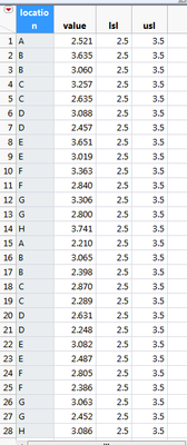

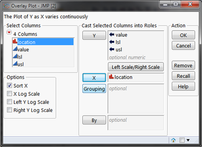

If you have the spec limit in the table as columns, then you can use overlay plot. But it doesn't provide any statistics.
10170_pastedImage_0.png10170_pastedImage_0.png10171_pastedImage_1.png10171_pastedImage_1.png
