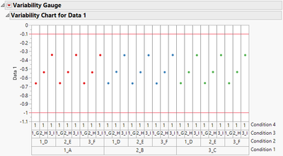

How to add reference line with different values to multiple different plots all at once?
I am a beginner and have no coding experience.
Although reviewing many related solutions, I still have no clue.
Currently, I'm manually adding these reference lines, but there are hundreds of plots (and each with different reference line).
I'm wondering if there's a quicker way (script...) I can refer to.

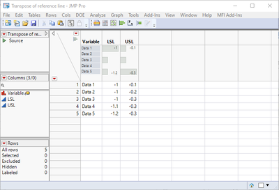

I've attached the file I made plots and the values I want to add as reference lines.
If the file format needs to be organized into a more convenient format, please let me know.
Thank you very much.
reference line value:
Data 1Data 2Data 3Data 4Data 5
-0.1-0.2-0.3-0.3-0.3
-1-1-1-1.1-1.2

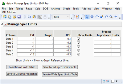

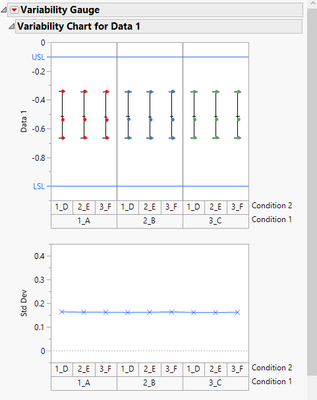

I would suggest checking out Specification Limit column properties and how to set those. You will have to change your reference line table to different format, but should be easiest option
Load from Limits table
In some cases you cannot use specification limits and then pure scripting solution is most likely the easiest

It works!
I can't thank you enough.
Thanks again!
