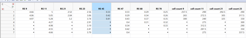

Calculate mean and standard deviation for each columns
Is there any way write a script to calculate mean and standard deviation for each columns and put them in new columns.
The test data is attached here.

Easiest is most likely to stack your data, add new columns for statistics and then split the data again if needed.
-Jarmo
txnelson
Re: Calculate mean and standard deviation for each columns
One way to solve this issue, is to use the Tabulate Platform to generate the statistics, and then to use
     Tables=>Update
to attach the new statistics data table to the original table.
Both the Tabulate Platform and Update Platform surface the JSL, so only minor modifications had to be made to put the 2 pieces of JSL together into one script.
