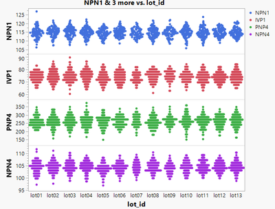

which gives

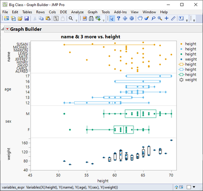

However, I would something like the following

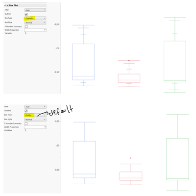

Re: How to add box plots to points when supplied Y variables as list to graph builder?
I think you used default "Box Plot" Outliers.
Are you looking for "Box Plot" Quantile method that connects all points?
Graph Builder(
Size( 1135, 705 ),
Show Control Panel( 0 ),
Variables(
X( :“S-b"n ),
Y( :C),
Color( :“S-b"n )
Elements( Box Plot( X, Y, Legend( 4 ), Box Type( "Quantile" ) ) )

Now what needs to be done, is to build
    Elements( Position( 1, 1 ), Points( X, Y, Legend( 1 ) ) ),
	Elements( Position( 1, 2 ), Points( X, Y, Legend( 2 ) ) ),
	Elements( Position( 1, 3 ), Points( X, Y, Legend( 3 ) ) ),
	Elements( Position( 1, 4 ), Points( X, Y, Legend( 4 ) ) )
The JSL that creates these lines of code is
For Each({y_col, idx}, y_values,
	Eval(EvalExpr(
		Insert Into(gb_expr,
			Name Expr(Elements(Position(1, Expr(idx)), Points(X, Y, Legend(Expr(idx)))))
It loops through each of the Y values and creates the Elements line one at a time, and inserts it into the Graph Builder() JSL.
Finally,
Eval(gb_expr);
Runs the completed Graph Builder JSL
So now, what needs to be changed.
Basically if one looks at what is different between the JSL the original script creates, and the saved JSL from the Graph Builder with the new modifications, in the original script output, the Elements structure is
Where the Saved code's Elements section has a section for both Points, and Box Plot
Elements(
		Position( 1, 1 ),
		Points( X, Y, Legend( 1 ), Jitter( "None" ) ),
		Box Plot( X, Y, Legend( 5 ), Jitter( "None" ) )
Therefore, all that needs to be changed is to add this second section to the code that generates the Elements section.
For Each( {y_col, idx}, y_values,
	Eval(
		Eval Expr(
			Insert Into(
				gb_expr,
				Name Expr(
					Elements(
						Position( 1, Expr( idx ) ),
						Points( X, Y, Legend( Expr( idx ) ), jitter( "None" ) ),
						Box Plot( X, Y, Legend( Expr( N Items( y_values ) + idx ), jitter( "None" ) ) )
If you put all of this together, the new script is
Names Default To Here( 1 );
Clear Log();
dt = Open( "$sample_data\Semiconductor Capability.jmp" );
y_values = {"NPN1", "IVP1", "PNP4", "NPN4"};
variables_expr = Expr(
	Variables( X( :lot_id ) )
For Each( {y_col}, y_values,
	temp_expr = Expr( Y() );
	Insert Into( temp_expr, Name Expr( As Column( dt, y_col ) ) );
	Insert Into( variables_expr, Name Expr( temp_expr ) );
gb_expr = Expr(
	Graph Builder( Show Control Panel( 0 ) )
Insert Into( gb_expr, Name Expr( variables_expr ) );
	Eval(
		Eval Expr(
			Insert Into(
				gb_expr,
				Name Expr(
					Elements(
Show( Name Expr( gb_expr ) );
Eval( gb_expr );
Jim

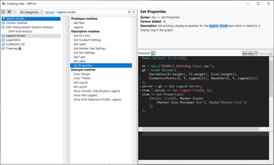

jthi
Depending on where you do it, where to see what will be different. Here is example if you do it from Legend:
Change it from legend and you get something like
{Legend Model(4, Properties(0, {Marker("Circle")}, Item ID("NPN4", 1)))}
So search for Legend Model from Scripting Index
Get the script from there, modify it to fit your needs but keep it as simple as possible (add second Y-axis) and test it out
Names Default To Here(1);
gb = dt << Graph Builder(
	Size(528, 448),
	Show Control Panel(0),
	Variables(X(:sex), Y(:height), Y(:weight)),
	Elements(Position(1, 1), Points(X, Y, Legend(3))),
	Elements(Position(1, 2), Points(X, Y, Legend(1)))
server = gb << Get Legend Server;
item = server << Get Legend Item(1, 1);
item << Set Properties({Marker("Circle")});
You managed to change markers on one plot. Then you ask: how do I change them on all of the plots? Then explore the script in more detail and it seems like there are some indices provided
check << Get Legend item from scripting index and hope that it is there and if it isn't explore other legend related objects and hope they work in similar manner (or just try to send messages to the server << get lege Ctrl+Space here).
server << Get Legend Items;
{{LegendModelItem(Label("height"), Type("Marker"))},
{LegendModelItem(Label("weight"), Type("Marker"))}}
Now you have a list of legend items. Try looping over that list and see what happens
