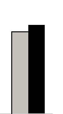

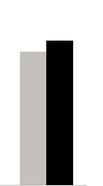

For visual enhancement purposes I would like to put borders around each bar to make them stand out, though I cannot figure out if it's possible to do in JMP. This is do-able in Excel, but making charts of summarized data is a pain to make each time.
Here is how it looks in JMP followed by what I am trying to achieve:
11838_pastedImage_0.png11838_pastedImage_0.png11839_pastedImage_1.png11839_pastedImage_1.png
Any help is much appreciated. Thanks.

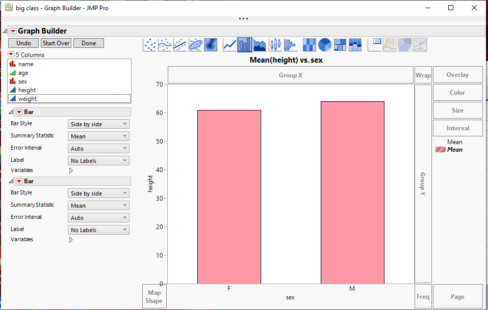

The only way I could figure out to do this, was to specify the Bar chart twice to Graph Builder, and then change the top one to have an empty fill pattern and to change the color of the top one to black.  It then shows only the outline of the bar.
