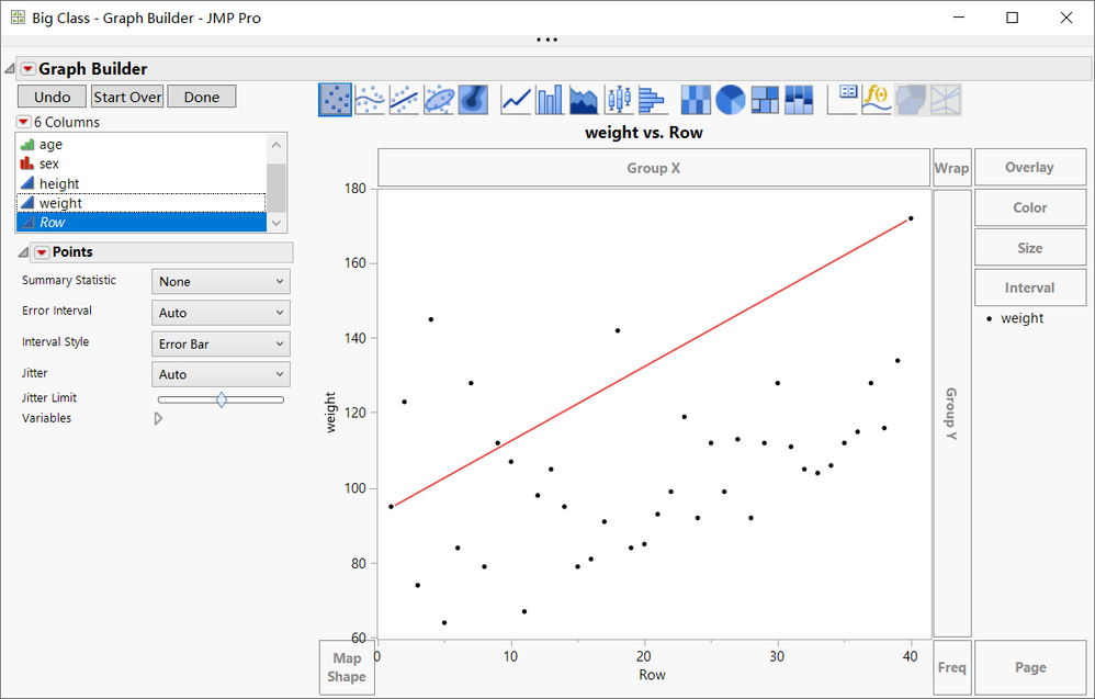

jthi
Re: How to add a connection between the first point and the last point in this diagram?
Names Default To Here(1);
gb = dt << Graph Builder(
	Variables(X(Transform Column("Row", Formula(Row()))), Y(:weight)),
	Elements(Points(X, Y, Legend(6))),
	SendToReport(
		Dispatch({}, "400", ScaleBox,
			{Legend Model(6, Properties(0, {Marker Size(2)}, Item ID("weight", 1)))}
fb = Report(gb)[FrameBox(1)];
ms = fb << Find Seg(MarkerSeg(1));
xs = ms << Get X Values;
ys = ms << Get Y Values;
fb << Add Graphics Script(
	Line({xs[1], ys[1]}, {xs[N Items(xs)], ys[N Items(ys)]})

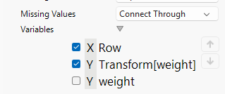

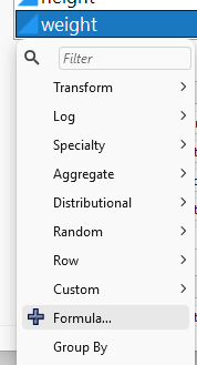

Via right Click you can add a Transform Column to Graph Builder
 Use it to keep the first and last data point.
Then use the Line Plot to connect the 2 points.

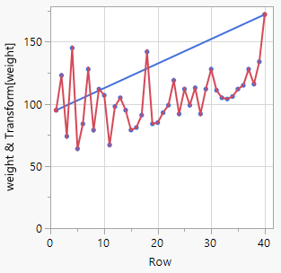

if you don't want to see the lines between the original data points,
you can disable them:

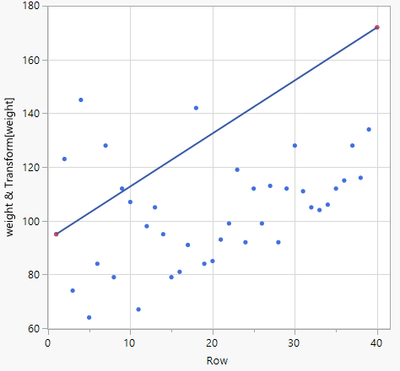

The final graph:
Graph Builder(
	Transform Column(
		"Transform[weight]",
		Formula( If( Row() == 1 | Row() == N Rows(), :weight ) )
	Transform Column( "Row", Formula( Row() ) ),
	Variables( X( :Row ), Y( :weight ), Y( :"Transform[weight]"n, Position( 1 ) ) ),
	Elements( Points( X, Y( 1 ), Y( 2 ), Legend( 6 ) ), Line( X, Y( 2 ) ) )
