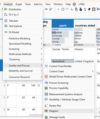

The Diagram function in the analyze / Quality and process menu is very helpful.
One can generate fishbown, hierarchical and nested diagrams.
Digging up Bones: Fisbone Diagrams
On the other hand, compared with the Graph Builder functionality in JMP18, it feels "outdated":
- no color dropzone [colors have to be applied manually, step by step for each entry]
- no Overlay dropzone - which could be used to control font settings
- no | X /Y Group Dropzones to structure the plot
   the only option is a [by] dropzone - which removes the chance to save a script for the whole graph
The largest problem:
After adjusted fonts and color settings, the plot is not saved as a platform script. Instead, the script generates the plot as it is.
 After adding new rows to the data table, the plot has to be generated from scratch.
a) Is there a functionality in Graph Builder which allows the user to generate such plots?
... with all the benefits/formatting options of Graph Builder?
b) Who uses the diagram function in Graph Builder?
How do you format and update the plot ? Could you share your experience  & useful tips?
