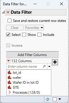

Something like this would be good, the main point would be for the specific graph for to appear when i click/check/search for it.
After doing some research, a column switcher seems good, so does a local data filter.
Re: How to add a Search system/filter to Report?
After playing around with the column switcher, I realized that this is essentially what I want. I'm wondering if the column switcher has a search function like in image I shared in my previous comment (the search function that puts "Enter Column Name"):
If it is possible to do with this data filter, it would also be good
Column switcher does have search capabilities
Usually if you can do it with column switcher but not with data filter, you would have to stack your data to get it into format usable by filters.
-Jarmo
