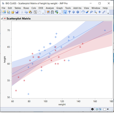

There are a few different platforms that can be used to plot trend lines for different subgroups.
Scatterplot Matrix'
  1. Go to     Graph=>Scatterplot Matrix
  2. Specify the X and Y columns to use
  3. Specify the Group variable to be Sex
  4. Once the graph is open, select Fit Line from the red triangle.
  5. To change the color and the markers, go to the data table
    1. Select all of the rows for the males
    2. Go to Row State column for one of the selected rows and right click and select the color to use
    3. Right click again, and select the marker to use
    4. Repeat the above three steps for the females

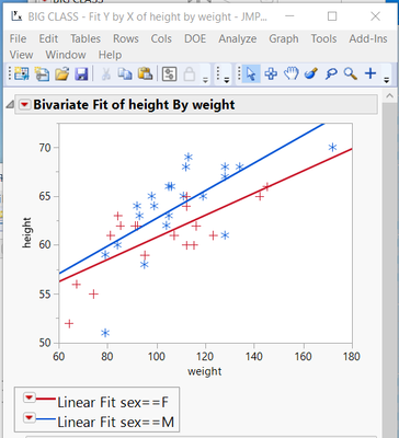

Fit Y by X
  1. Go to    Analyze=>Fit Y by X
  2. Select the X and Y columns
  3. In the output display, under the red triangle, select Group By and select the Sex column
  4. Under the red triangle, select    Fit Line
  5. Change the marker and the color of the points as was done in the Scatterplot Matrix, by changing the Row State values for each of the sexes.
