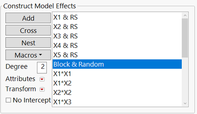

This is really interesting. You effectively have "nested" blocking factors.
Having said that, I think you can just keep it simple. Here is something that you can try...
Use Custom Design to create a 32-run RSM design for 5 continuous factors and an 8-level blocking factor (4 runs per block) for incubator. This will ensure that the blocks are minimally correlated with the effects that you really care about.
Then just run blocks 1-4 on day 1 in incubators 1-4. Then run blocks 5-8 on day 2 in incubators 1-4. You can manually add Day and Incubator columns to your data table in case you need to use it later.
Once you have collected that data you can fit the RSM model for the 5 factors plus a random effect for the blocks. The advantage of using a random effect is that it does not consume all the degrees of freedom that a fixed factor effect does.

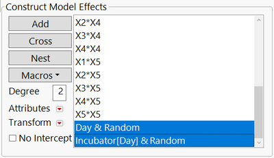

Now you could get fancy and fit the RSM model for 5 factors plus a random effect for Day and a random effect for Incubator nested within Day. Strictly speaking that is probably a more appropriate model.
However, I think this is probably overkill. I doubt that it will make any important difference to your conclusions. The simple model with a random effect for block should be able to adequately capture all the variance due to differences between incubators and days.
I have attached an example design with the 2 models saved. The Y response is just random.
I hope this helps.
