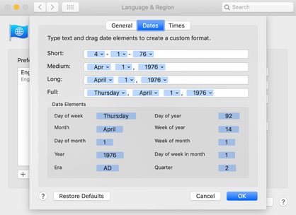

System Service sounds like and interesting function, but I couldn't find any documentation on it.  I'm looking for a general solution but am immediately interested in finding the date format, (per setting in System Preferences ➔ Language & Region ➔ Advanced... ➔ Dates ➔ Short), as shown below:
The Short date delimiters are normally set to slashes by default, but were modified by me to dashes in the image above.  The specific issue I find with changing this setting is that it affects what arguments are valid to the Input Format function.  For example, the following statement will generate a runtime error:

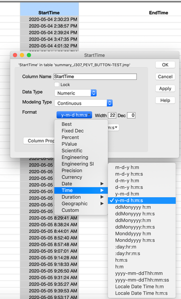

However, this seems a bit clumsy, and I imagine there's a simpler way.  It's apparent that the JMP engine can read this setting as it presents a very different set of time formats in the Column Properties dialog based on this setting, as shown below (presenting only the dash options here):
So, my question is:  Is there a simple way to get arbitrary System Preferences values (and the date format specifically) by using System Service or some other function?
