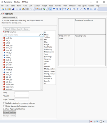

I'm having an issue where I want to tabulate the sum and n for each test in a large testprogram. I'm not sure what my issue is, but would appreciate some guidance. The code compiles and outputs the Tabulate window as seen below, but isn't populated.

Re: How to Use a list of Columns as Analysis Columns in Tabulate?
That is really disappointing - I just need to practice my spelling I guess!
Here is an example output from the Tabulate window. In practice the number of rows will be much larger. Follow up question, is there a way to get the Sum/N into a column for each temperature from the Tabulate window? I've been manually doing it, but was wondering if there is a simple way to do this from the Tabulate window?
