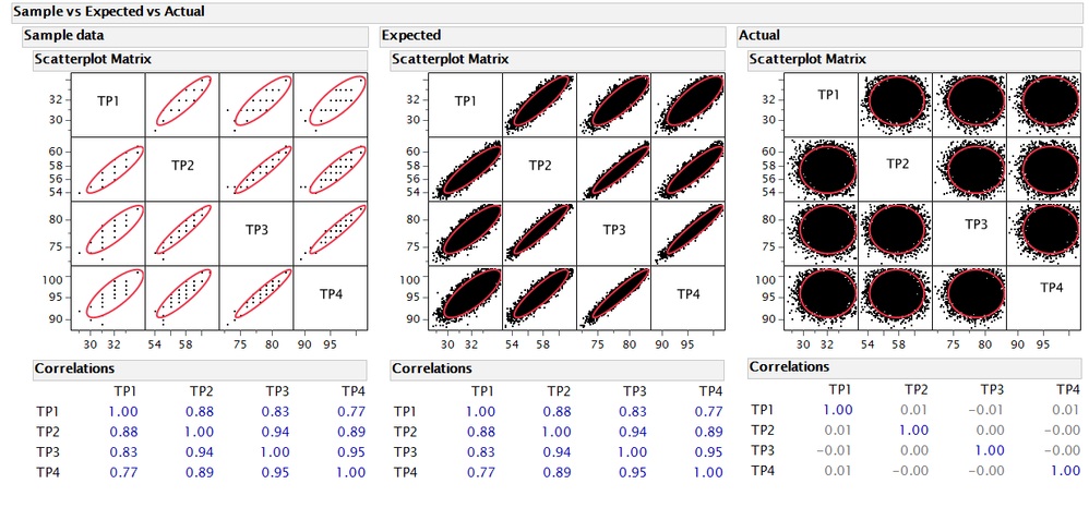

Hello,
I am writing a script to create multivariate normal data with a specified number of rows, mean/standard deviation vectors, and correlation structure from a set of sample data. I would like to take advantage of the Simulator in the Profiler platform to generate the data table through the following steps:
  1. Calculate sample mean and standard deviation for each variable.
  2. Generate correlation matrix from sample data.
  3. Simulate multivariate data using the summary statistics from (1) and (2).
Currently, my script generates the simulated data table with the appropriate means and standard deviations for each variable, but I cannot manage to maintain the correlation structure between variables correctly. I believe the cause of my issue is how I specify the [NxN correlations] with X Correlations using a variable instead of explicitly specifying the correlation matrix (e.g. [1 0.3 0, 0.3 1 0, 0 0 1]), but my troubleshooting skills have left me with no solution. Current script and expected vs. actual output provided below, any suggestions on how to achieve these steps are welcomed:

Expected vs. actual output:
expectedvsactualexpectedvsactual
